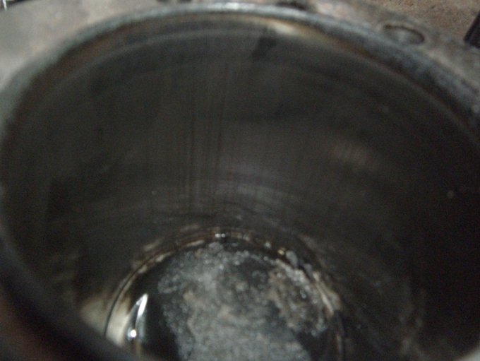

just gas I found my rattle one of my wrist pin keepers came out. How do you get those out? Mine are like flat key chains. They overlap almost 50% of each other. since I'm replacing I drilled them

Take a small flat blade screwdriver, then lift the end a little and hold it out of the groove, get a second small screwdriver and run it around, like taking a tire off a rim.
March 16, 2014 5:59 AM PDT
there's no way to grab it, they overlap. I tried the screwdrivers. these are not C-clips

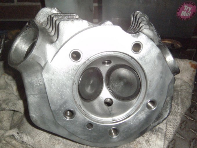

doesn't matter I got my Weiscos in and they use c clips. Besides if pistons come off new ones go on. All my parts are in but I got to put all my time in building the trailer for Augusta. I got one head finished tonight
March 23, 2014 1:01 PM PDT
Between working on that trailer and trying to get the bike running I'm tired!. Got my heads finished, my cylinders honed. Ready to put them in the dishwasher when no one is looking. painting all of it black pearl.
